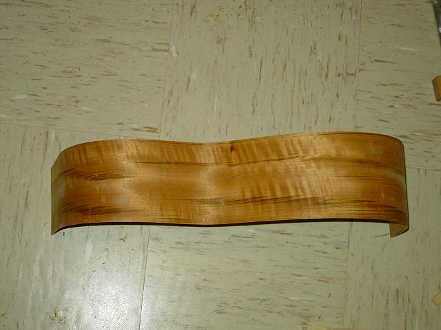

I just started building a classical out of goncalo. So far I've only joined & thicknessed the back, and bent the sides. No problems with the either operation.
Matt
Matt Jacobs
"Don't tase me bro"

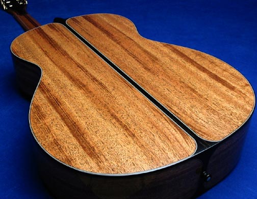

Grant Goltz made a beautiful Goncalo Alves guitar. Maybe he'll post a pic... Grant?
Dennis
Dennis Leahy
Duluth, MN, USA
7th Sense Multimedia

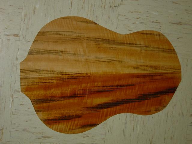

Here are some pics. on the Back I wiped half with naptha. The black steaking is part of the figure. This set happens to have some curl in it.
Matt Jacobs
"Don't tase me bro"

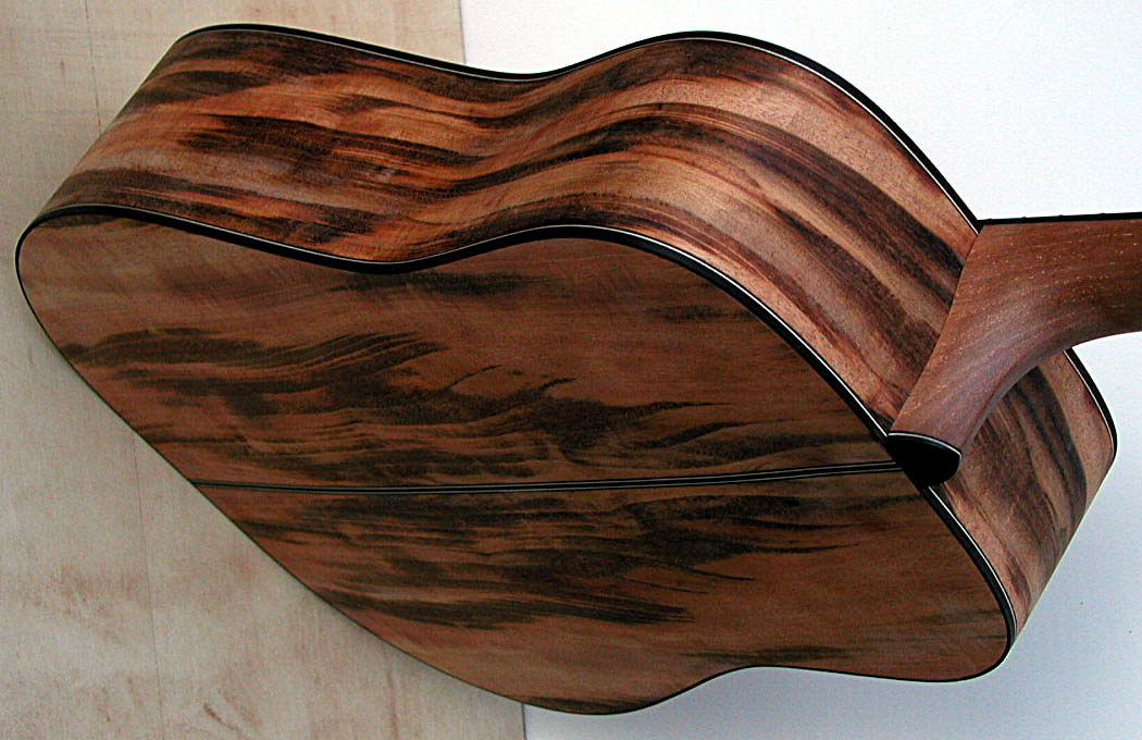

Here is the guitar Dennis mentioned.

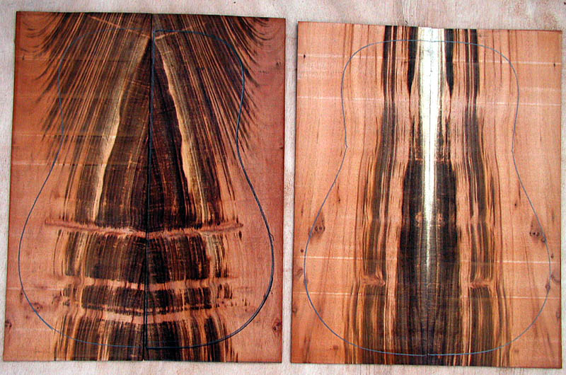

And a couple of back sets.
This wood is extremely variable with no two pieces looking the same. Unless they are from the same log, then they can be remarkably consistant. The best wood comes from Central America. There is a Brazilian variety, but it has less color and is less dense.
Grant
PostPosted: Thu Aug 24, 2006 2:28 pm
Still makes a nice flamey set Grant, really nice guitar!
